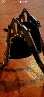

Fromafar Posted 4 hours ago Report Share Posted 4 hours ago 1 hour ago, THE DEAN MACHINE said: It’s near on impossible to cheat at World Cup or GP level, not saying it hasn’t happened but most are just looking for an advantage within the rules(like the current trend of jhr rear frames)but I think people mistakenly confuse speedway with other motorbike sports, more power doesn’t mean more wins, it means more wheel spin and the slicker the track the more you will go nowhere, power means nothing if you can’t get the rear wheel to grip,,take the example of smolinski in earlier post he cheated by pulling a wire apart mid race but it didn’t make his bike have more power it made it less power and the back wheel to hook up better on the slick track, the difference with polish riders and their ability to adapt is their training from an early age on how a bike works, most polish riders can strip and rebuild engines, a lot of British youngsters don’t understand the importance of having a clean air filter What’s the JHR rear end advantage(if any) Quote Link to comment Share on other sites More sharing options...
THE DEAN MACHINE Posted 3 hours ago Report Share Posted 3 hours ago (edited) 1 hour ago, Fromafar said: What’s the JHR rear end advantage(if any) I’ve never tried one but the bottom tube is like a square tube design so I would imagine it makes the bike drive more but and this is my opinion only it makes the bike very unpredictable on less than perfect tracks.3 riders who use them are lambert, Doyle and lindgren who are all very fast this year but have randomly had moments where the bike has just taken off in the middle of the corner but I suppose if I they feel it works 90% of the time it’s worth the risk in their mind, traction control is banned in speedway so they are trying to sort of create it with frame modifications, I know zmarzlik has brought a lot of them but isn’t using them at moment and well he is world champion so do they work ? Edited 3 hours ago by THE DEAN MACHINE 1 Quote Link to comment Share on other sites More sharing options...
ONTWOMINUTES Posted 2 hours ago Report Share Posted 2 hours ago 17 minutes ago, THE DEAN MACHINE said: I’ve never tried one but the bottom tube is like a square tube design so I would imagine it makes the bike drive more but and this is my opinion only it makes the bike very unpredictable on less than perfect tracks.3 riders who use them are lambert, Doyle and lindgren who are all very fast this year but have randomly had moments where the bike has just taken off in the middle of the corner but I suppose if I they feel it works 90% of the time it’s worth the risk in their mind, traction control is banned in speedway so they are trying to sort of create it with frame modifications, I know zmarzlik has brought a lot of them but isn’t using them at moment and well he is world champion so do they work ? As far as I'm aware jhr have made a couple of rear ends over the years that are different to conventional rear ends made by the likes of jawa and stuha. Quote Link to comment Share on other sites More sharing options...
THE DEAN MACHINE Posted 1 hour ago Report Share Posted 1 hour ago This is the jhr rear end, not the best photo but you get the idea Quote Link to comment Share on other sites More sharing options...
Fromafar Posted 1 hour ago Report Share Posted 1 hour ago 3 minutes ago, THE DEAN MACHINE said: This is the jhr rear end, not the best photo but you get the idea I must be hard to to tell if it really any better given all the different styles and weights of the riders.Woffy had a article in SS suggesting riders weight is a big important factor. Quote Link to comment Share on other sites More sharing options...
THE DEAN MACHINE Posted 22 minutes ago Report Share Posted 22 minutes ago 58 minutes ago, Fromafar said: I must be hard to to tell if it really any better given all the different styles and weights of the riders.Woffy had an article in SS suggesting riders weight is a big important factor. I think it’s about the flex of the tube and the bottom tube won’t flex a much as a normal tube so making the bike want to go straight line quicker Quote Link to comment Share on other sites More sharing options...
